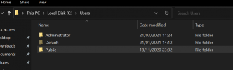

I mean open an explorer window. Click on "This PC" in the left column. Then double click "Local Disk (C)", then double click the User folder. Is there a folder in there with your user name in it?
1,762
407
Unfortunately your user account is completely gone. I was hoping that the login was gone, but the folder still there. If it was I was going to suggest a system restore. Doing a google search, I only found one instance of this happening. And there was never a solution. There's probably nothing of use in the Public folder. With your user account gone, you probably can't access it anyways. I wish I had a solution for you. Maybe someone else has some insight.

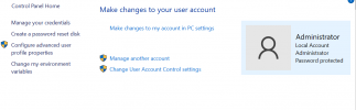

What happens when you click on Control Panel > User Accounts > Manage another account?. :)
Mar 21, 2021
9
Only this
