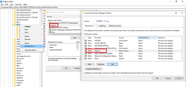

  • Right-click on the Dhcp key In the left pane and select Permissions
    Sample image
  • In the window that opens click the Add button
    Sample image
  • In the next window that opens type network service in the empty field then click Check Names button.
    This will open the window again showing NETWORK SERVICE in the field. Click OK
    Sample images
  • This will return you to the Permissions for Dhcp window. Check the Full Control box under the Allow column, then click OK
    Sample image

The Network Service is an actual account.
Thus granting full access to this account comes with an element of risk.
You can mitigate this by approaching your issue in a slightly different way, by expanding the Dhcp hive and applying Permissions to your User Account, for the Sub-key named Configuration. Granting yourself full control comes with its own risks, but at least limits the access to your account only.
Rather than post an entire new post on a topic I covered several years ago, I'll suggest you take a look at the following article posted by AnandK where he fully explains this alternate method to achieve the same outcome.
