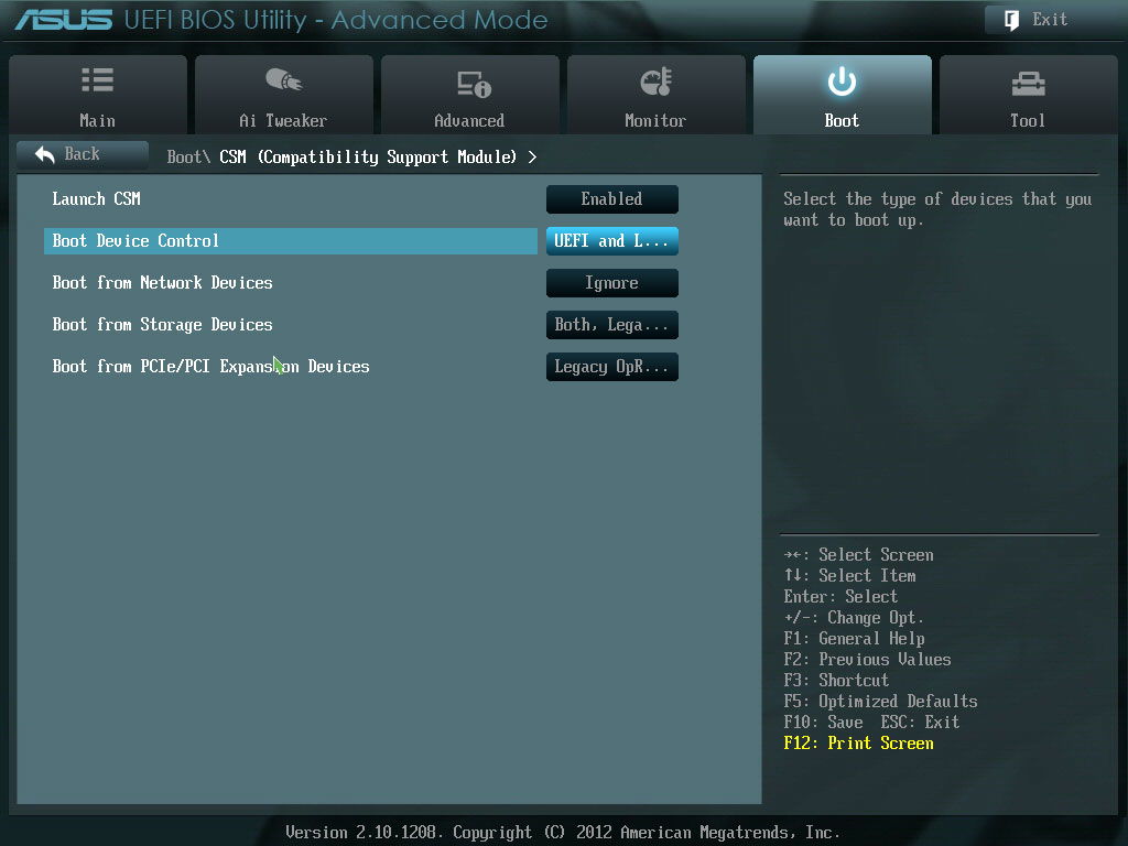

Something that might be pertinent OR perhaps not, but we've seen it before....
You should know that IF
Your install was done in compliance with UEFI / GPT standards and somehow your BIOS has been altered to legacy configuration...
That is Safe Boot has been disabled and or LEGACY has been chosen explicitly from your boot options, THEN.... your system will not boot.
IF
On the other hand your install was done in compliance with Legacy Standards and somehow the reverse has happened and your BIOS has been configured in such a manner as to support UEFI / GPT, THEN likewise your system will not boot.
It's important that you have at least a minimal understanding of what these two options entail so that you can experiment between the two and see if THAT might be what you are encountering.
Remember... It has nothing to do with what your system is capable of... It has everything to do with the state of the system when the install was performed and what state the system is currently configured to support.
That is to say what the boot process is looking for Windows Boot Manager (in the case of UEFI) OR ...
A simple MBR partition with the system files in the case of a LEGACY install.
This may help a little bit
Or not
