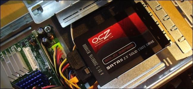

How about you post your actual speeds your SSDs, Here is a good description of the differences of SSD and an explanation of the technology.
I'm posting my slowest SSD this is Samsung 1 TB 960 Evo, 2.5 format SATA 3.0. the maximum speed of the SATA Controler is 500 MB/s as you can see this one is using all most all of that.
You should also know that SSD are not all created Equal some off-brand or little know brands can be quite slower than other brand using the latest chip technologies
