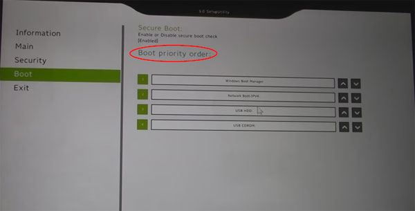

Jul 29, 2016
19
That's what my BIOS looks like. There's no switch to toggle legacy boot on. Plus, I want to wipe Windows 10 and install Elementary OS.

Jul 29, 2016
19
I said there is no switch in the BIOS to toggle legacy boot on.

Jul 29, 2016
19
It says the file is too large but all there is is secure boot (enabled/disabled) and the boot menu.
Jul 29, 2016
19
That's what my boot tab looks like. I found the exact version off google.
