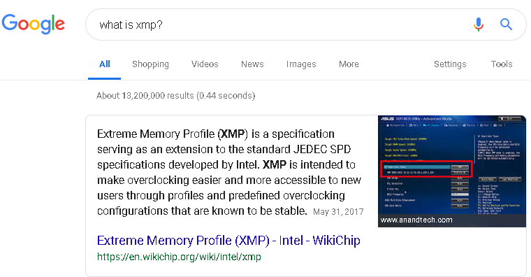

Never cared much for so called "memory profiles". XMP by definition stands for Extreme Memory Profile and in function is more or less a generic overclock. I always disable it, consult the RAM manufacturer for recommended timings and voltages and set them accordingly.
So disable the XMP profile and manually over clock my ram to the timings and speed that is printed on the side of the dimms?

Right. I only meant that if I run the RAM without XMP enabled, the RAM only runs at 2133Mhz. How would I get the RAM to run at the advertised speed of 3200Mhz without XMP?
