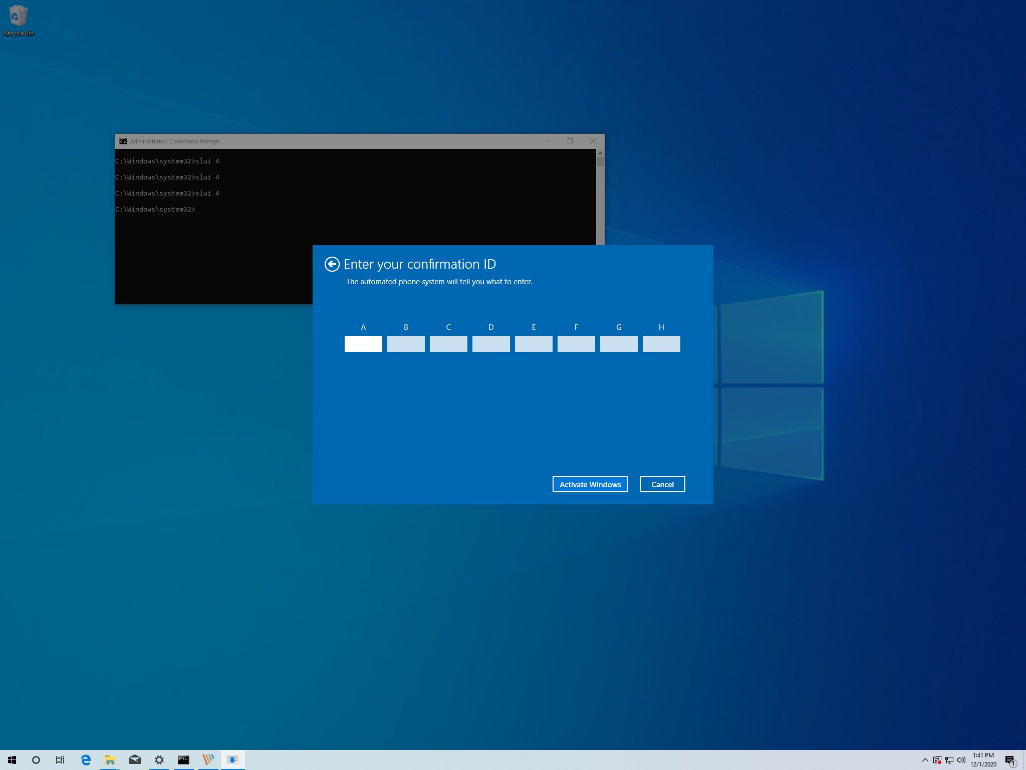

Treading on delicate ground here. But, you state you purchased the Pro?
I would suggest that you could deactivate the Dell pro, and use the same key to reactivate the cloned pro on your new HP.
In the past, if this failed to activate, a phone call to MS usually did the trick.
Just a guess, from antiquated memory. :rolleyes:

6,298
The Dell will revert back to the original oem home licence. You will probably need to reinstall it, if there is no longer a backup from the factory or retailer
