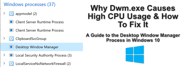

C:\Windows\System32\dwm.exe
Hi Ollie,
this might help?. :)

Hi Ollie,
Thanks but as I wrote I just did a factory reset so windows update or graphics driver update is not relevant I guess. The GPU is Inter(R) UHD and it says the best drivers are already installed.
