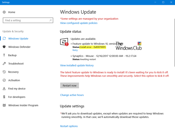

DISM was run again with result successful same as sfc /scannow. A Restore point was also ran but showed again it was unsuccessful with an error Ox80070005 what ever it means.
