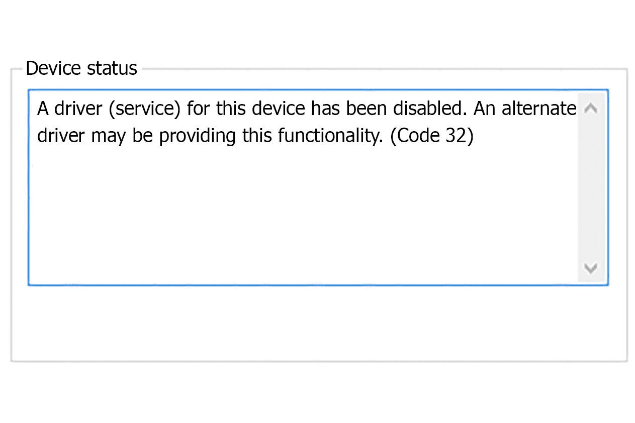

Just imaged my machine along with installing x new m.2 SSD.
I noticed in the device windows for processors that each individual core was displaying the yellow explanation marks.
Message:
"A driver (service) for this device has been disabled. An alternative driver may be providing this functionality. (Code 32)"
Windows update is upto date.
Unable to update driver locally.
Everything appears to be fine.
9842
Any ideas of what I need to do to resolve this please.
Thank you.
M

The HW change ha been replacing the OS drive.
Ive rebooted, searched for drivers. Not sure why this is happening or how to resolve.
Dont really want to remove new drive.
The attached information messages as follows (not sure if any help) under the individual core properties of the processors:
Events / Device migrated:
Device ACPI\GenuineIntel_-Intel64_Family_6_Model_85-Intel(R)_Core(TM)_i7-7820X_CPU@_3.60GHz\_0 was migrated.
Last Device Instance Id: ACPI\GenuineIntel_-Intel64_Family_6_Model_85-Intel(R)_Core(TM)_i7-7820X_CPU@_3.60GHz\_0
Class Guid: {50127dc3-0f36-415e-a6cc-4cb3be910b65}
Location Path:
Migration Rank: 0x0
Present: true
Events / Device Configured (cpu inf):
Device ACPI\GenuineIntel_-Intel64_Family_6_Model_85-Intel(R)_Core(TM)_i7-7820X_CPU@_3.60GHz\_0 was configured.
Driver Name: cpu.inf
Driver Date: 04/21/2009
Driver Version: 10.0.17763.1
Driver Provider: Microsoft
Driver Section: IntelPPM_Inst.NT
Driver Rank: 0xFF0004
Matching Device Id: ACPI\GenuineIntel_-_Intel64
Outranked Drivers: cpu.inf:ACPI\Processor:00FF2000
Device Updated: false
Parent Device: ACPI\ACPI0004\CPUSCK0
Events / Device started (intelppm)
Device ACPI\GenuineIntel_-Intel64_Family_6_Model_85-Intel(R)_Core(TM)_i7-7820X_CPU@_3.60GHz\_0 was started.
Service: intelppm
Lower Filters:
Upper Filters:
Thanks
M

OK solved it. Turns out quite an easy one and appears nothing to do with the SSD.
The solution was as follows:
WHAT I DID TO FIX THIS ISSUE:
Disable automatic driver installation.
1) Opened Devices and Printers.
2) Right-clicked my computer's device icon and clicked on Device Installation Settings.
3) I set the option to No Let me choose what to do -> Never install driver software from Windows Update.
4) I kept the bottom checkbox checked.
Method 2: Reinstall the processor driver
Use Device Manager to reinstall the processor driver, and then restart the computer. To do this, follow these steps:
  1. Click Start
    Start button
    , type Devmgmt.msc in the Start Search box, and then click Devmgmt.msc.
    User Account Control permission
    If you are prompted for an administrator password or for confirmation, type your password, or click Continue.
  2. In Device Manager, expand the Processors node, and then double-click the first processor that is listed.
  3. Click the Driver tab.
  4. Click Update Driver.
  5. Click Browse my computer for driver software.
  6. Click Let me pick from a list of device drivers on my computer.
  7. Under Model, click the processor that includes the name of the manufacturer of your processor. For example, click the processor that corresponds to Intel, AMD, VIA, or another manufacturer. Click Next.
  8. Click Close.
  9. Repeat steps 2 through 8 for each processor that is listed under Processors.
  10. Restart the computer. After the computer is restarted, the correct processor information is listed in Device Manager under Processors.
