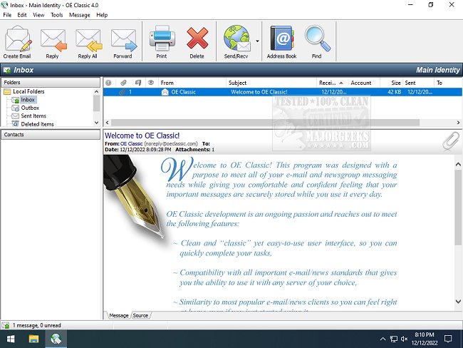

I am afraid it won't work. Whatever you want to put into the registry , the installation will only continue after a successful contact with the server. I provide an alternative for the runasxp version. Google search with "outlook express winramtech" to find my webpage.
The latest OE Classic:
