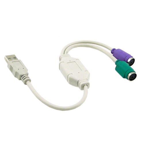

Hi all.
I have problems running my USB composite device with any stability. The device is connecting PS/2 trackball and PS/2 keyboard to the computer. When I have plugged in the USB composite device with trackball and keyboard connected to it, everything will run fine for maybe 10 minutes, maybe half an hour, some times even more, and then a message will pop up saying: "The last USB device you connected to this computer malfunctioned, and Windows doesn't recognize it." The driver that installs when I plug the device in is an old Windows one: Version 10.0.17134.1 from 21 June 2006. I have already tried – to the best of my ability – to uninstall USB entries in Device Manager, and rebooted to have them reinstall.
In short: The device works just fine, until it is "thrown off" and I am told it malfunctioned.
Hope you can help.

What I am trying to make work is this USB composite device. As it appears from the site linked to, the device is USB powered and receives no external power There is little info to identify the device and its maker. However, there is this string of characters on one side of the converter housing: ZL 2009 3 0066791.8, and on the bar code label on the packing it says: www.cablecc.com and U2-143, which is probably the seller and (his) product-id).
Nothing except PS/2-devices can be connected to the composite device without adaptor. Having tested my PS/2 mouse for three hours on my computer's PS/2 port, I think it is OK, and my PS/2 keyboard certainly is, cf. earlier post. So I think the problem lies with the composite device. Could it be that Windows 10 does not like it?

The device is registered as "not migrated". On the Events-tab under Properties for USB composite device in the Device Manager, it says "Device USB\VID_046D&PID_C52B\5&f6a6a5f&0&9 was not migrated due to partial or ambiguous match."
By the way, Device Manager shows two instances of the USB composite device. I have discovered that one of the two entries "USB composite device" is my Logitech trackball M570. When I keep the USB receiver for that device unplugged, there is only the entry for the PS2-splitter under USB-devices in Device Manager, AND the device does NOT have those radom stops, and I receive NO error massages ("The last USB device … malfunctioned and was not recognized by Windows." However, although I keep the Logitech M570 receiver unplugged, the note "Device … not migrated …" is still there in Device Manager on the Events-tab under Properties for the device, and whenever I shut down the computer, I have to unplug the device and plug it back in to make it work (i.e. in order to use my keyboard and trackball).
Do you, Trouble, or someone else have a clue as to why the device happily functions (and stably, provided I keep the trackball receiver unplugged), but insists on NOT migrating?

This is the device causing me trouble, a USB to PS/2-splitter, sometimes referred to as a type of USB composite device.

... whenever I shut down the computer, I have to unplug the device and plug it back in to make it work (i.e. in order to use my keyboard and trackball).
This morning I started up my computer (after it being shut down for the night) without any need for unplugging and replugging the device to make it work. However, the device is still "not migrated due to partial or ambiguous match".

I received my PS/2 to PS/2 keyboard and mouse splitter (StarTech KYC1MF) on February 20, and, so far, it works really well, and makes my old grey mouse (trackball) and keyboard work like in the good old days.:)
The PS2 to USB splitter that I was asking about, never really got to work in the sense that it never got migrated, as reported on the Events tab under Properties for the device (USB composite device). The fact that it did not get migrated meant that the device never got to work with total stability, although it worked without a problem for long periods (whole days), provided I kept my Logitech M570 USB-receiver unplugged. However, when I least expected it, the device could stop working, and it would be necessary to unplug and replug it to make it function again.
