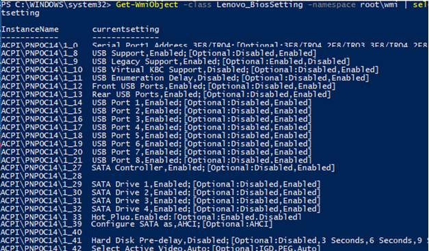

some manufactures have issued a app to instant boot to bios from Desktop called "UEFI Restart" I do love mine.
1. click to open, 2. slide to Enter UEFI on Reboot and 3. slide to reboot now and Im auto restarted to BIOS.
you might find this info helpful

Some interesting stuff there. Unfortunately, mine is not supported ( story of my life). Just under the threshold. I'll get it yet.
Thank you sir!
