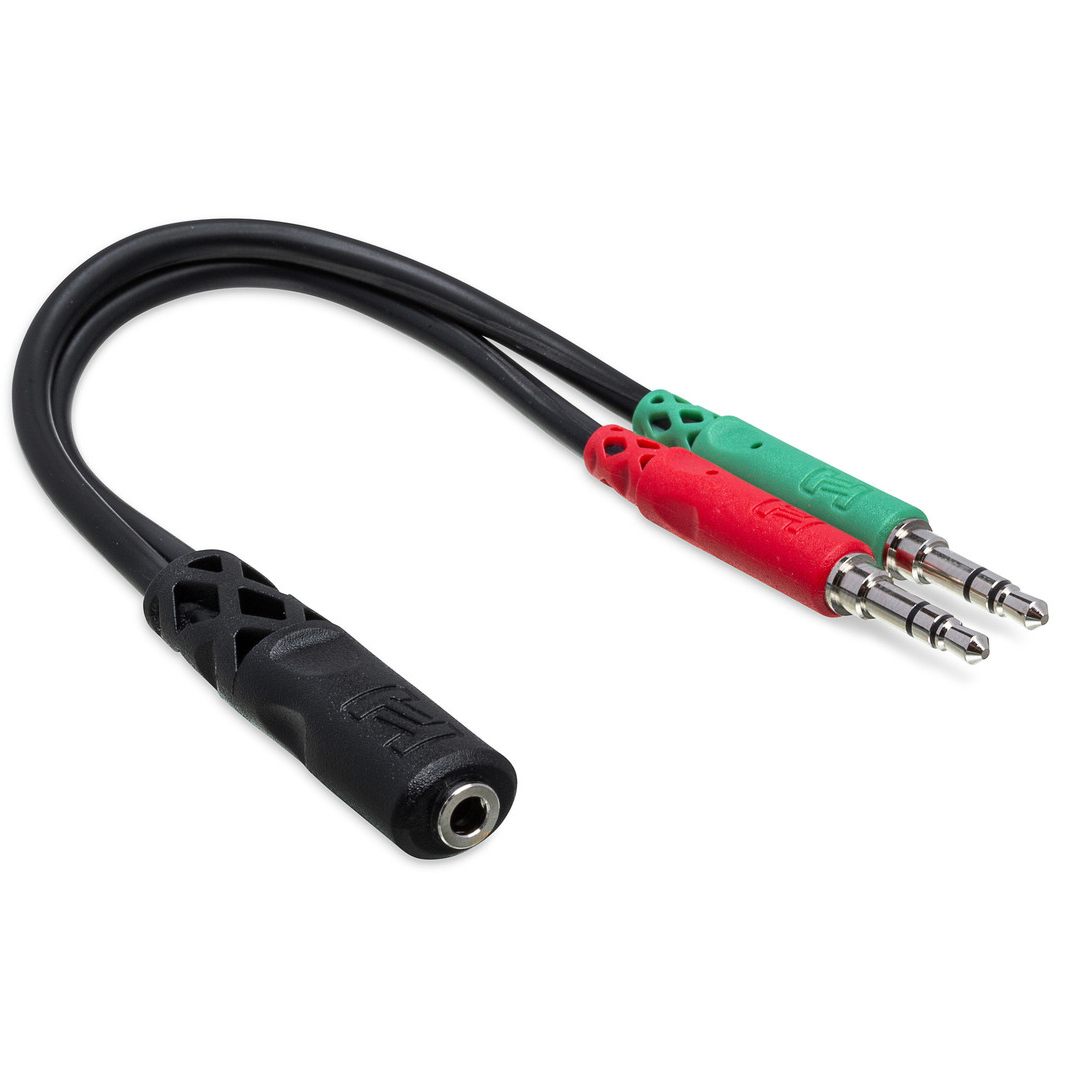

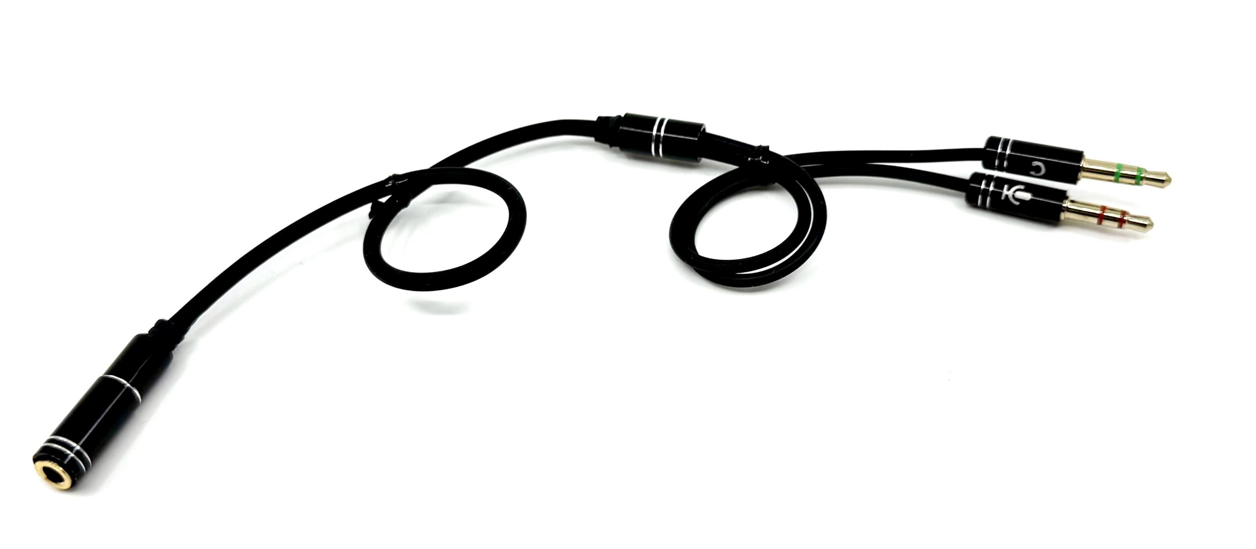

If your headset has one plug and the computer has separate headphone and microphone jacks, you probably need an adapter cable.
