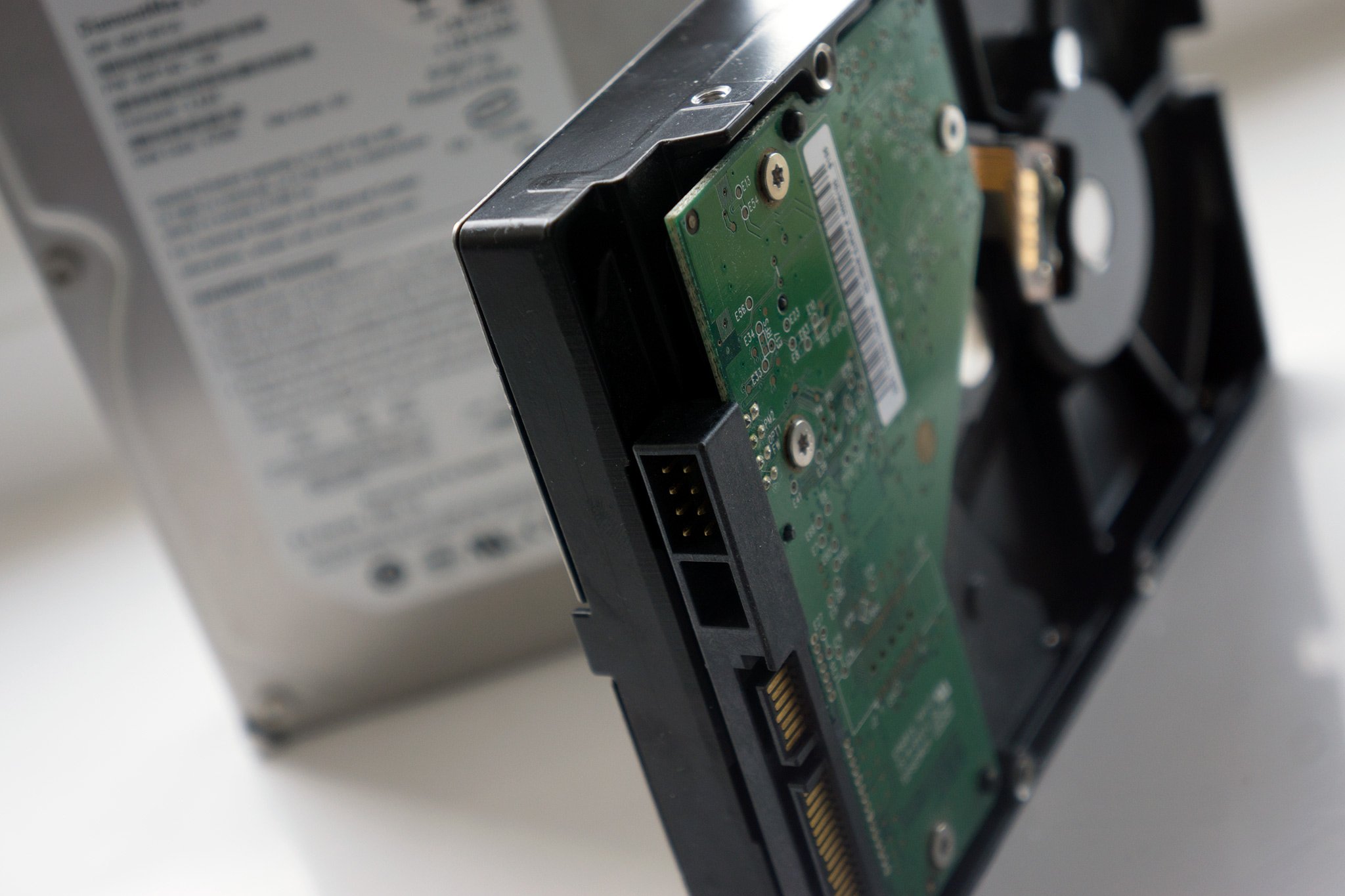

Open the panel and look inside, if you see a drive that looks like the big bulky thing in the following link, you have an HDD (AKA: spinner) drive!.
The slender looking drive is an SSD called M.2 but you would most likely need a normal SSD should you ever want to replace it as your motherboard most likely doesn't support M.2 drives!. Normal SSD's are about 4 x faster than an old HDD!. ;)
