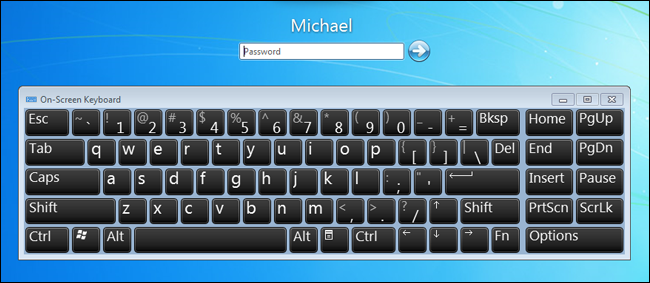

IF your mouse works and you can use that to get past the lock screen, you may be able to use the ease of access icon on the login screen to launch the On Screen Keyboard to get you through.
C:\Windows\System32\osk.exe

Read Troubles post for the on screen keyboard You need to click, bottom right, the little guy with his hands sticking out, then the keyboard
