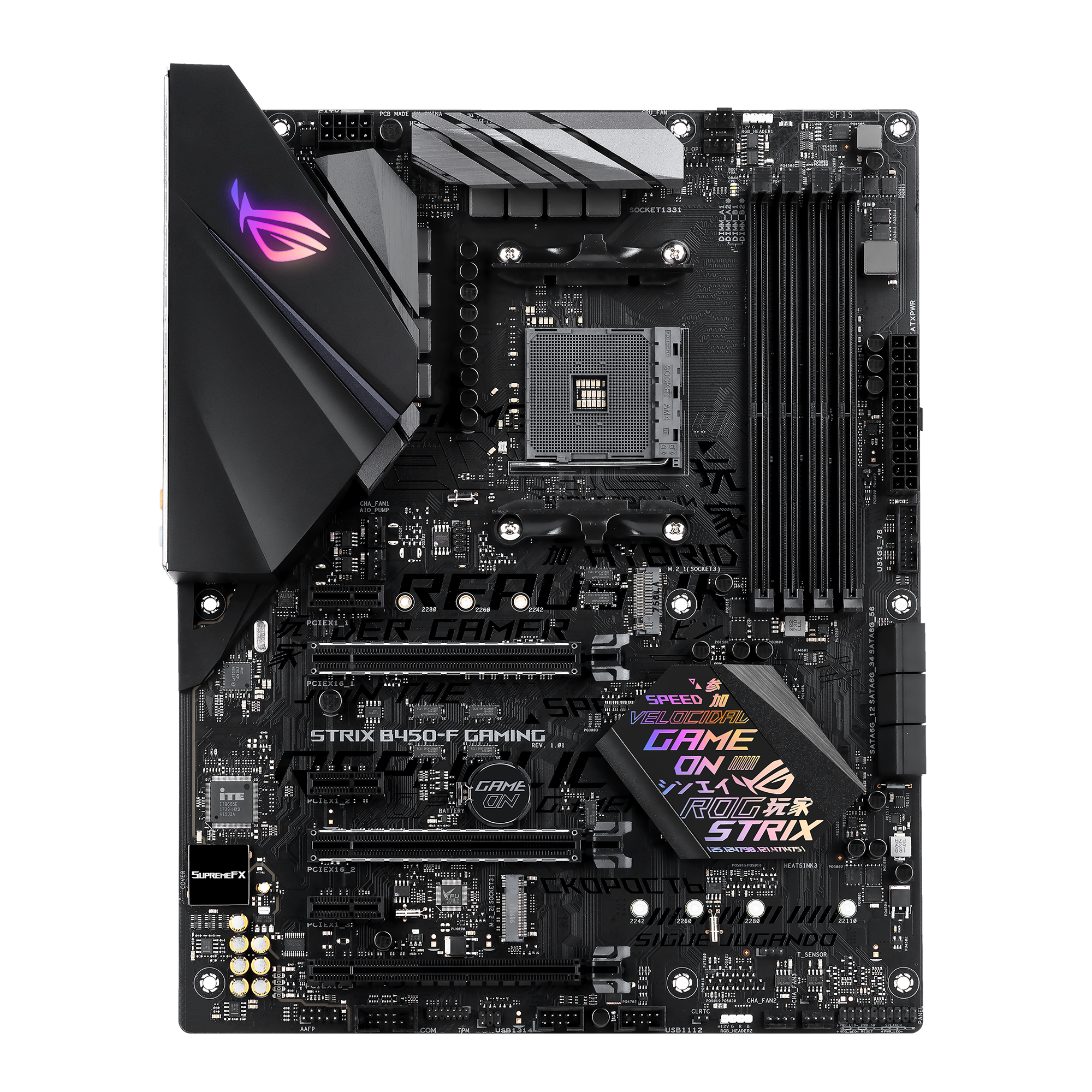

How (if at all) did the PC run using just the APU?.
Check the manual to see if it tells you about a rollback feature:
You said you tried to remove the GPU, did you actually remove it and just boot from the APU?. :)
