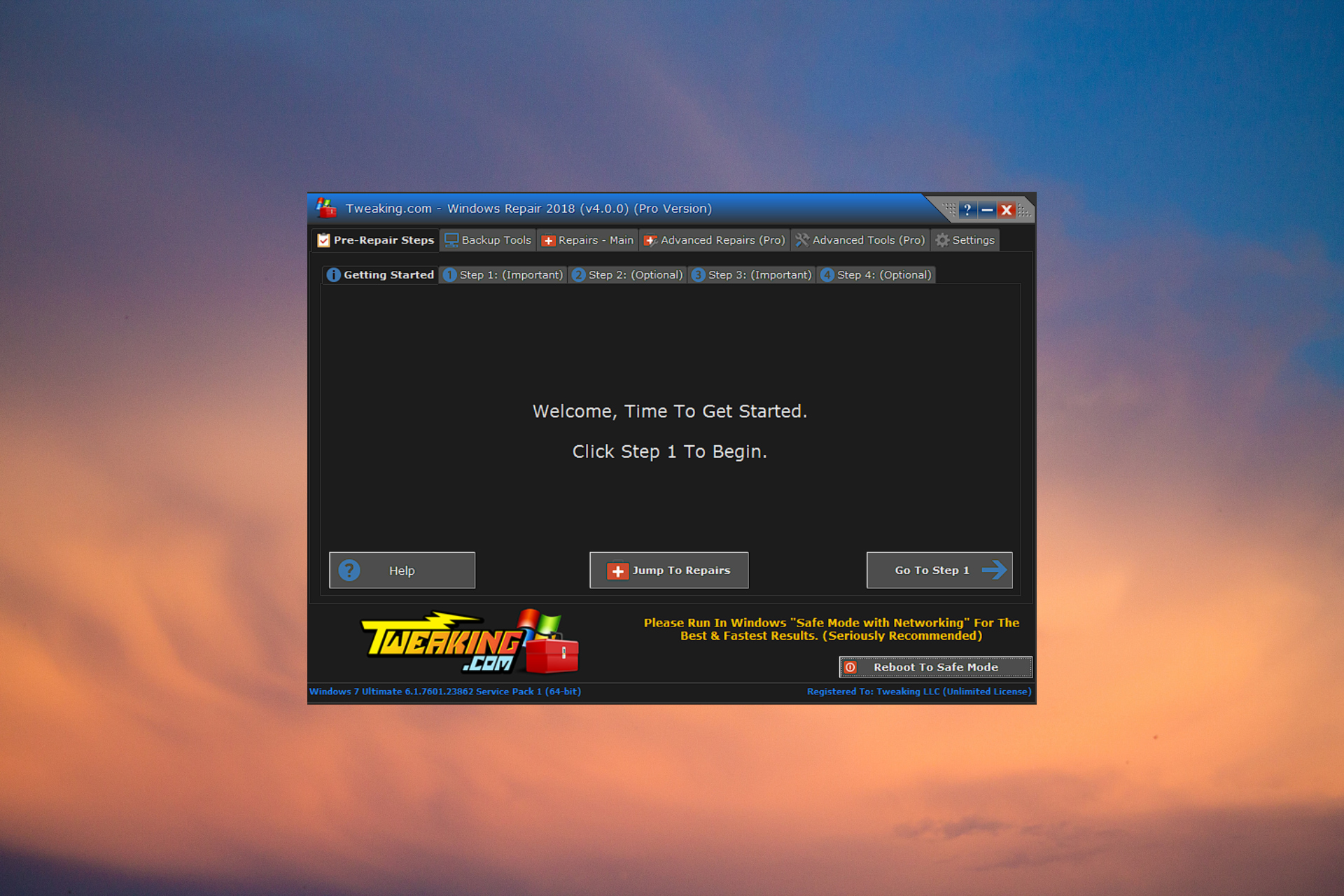

inaccessible one - have you did a repair update to reset all that might be corrupt or missing in System Files.
and only other thing is a AIO Repair program might do the job. They have a FREE one, also a paid on, i use the FREE and leave with
many clients,
tweaking.com_windows_repair_aio4.8
