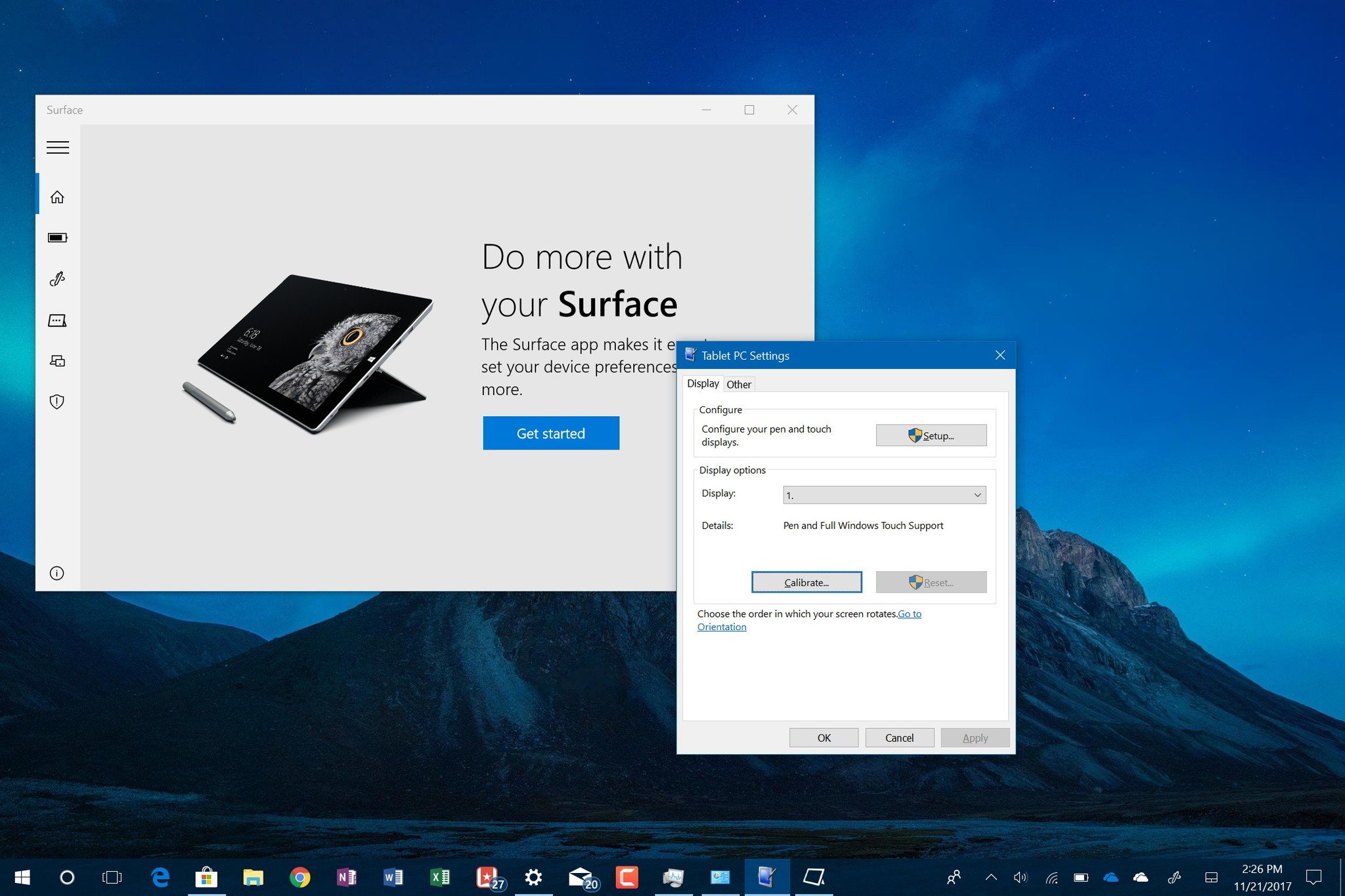

You say you've tried everything including reinstalling Windows 10. What was the everything you tried? Did you run the Setup for Calibrating pen and touch? See here if you are unsure how to do that:

there is no tablet and pc setting in sound and hardware on my version of windows.. There is no device plugged in either. i have windows 10 home edition . unknown usb device.. (failed device) in device manager.
