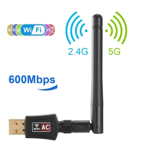

You can purchase a good USB Wifi adapter on either Ebay or Amazon for under $10. I bought 2, one for a laptop running XP and for my Dell HTPC with Windows 10. It is AC600 and comes with a removable swivel antenna (I keep the antenna connected for better reception). Based on the Realtek RT8811CU chipset It supports 802.11a, b, g, n, ac in 2.4GHz and 5GHz bands.
If you have a modern AC router this is definitely the way to go.
It definitely is an improvement on the Dell's built-in WLAN 1397 which was 802.11n 2.4GHz. Even though my router is in a different room about 50 feet away and through a wall Speedtest gives me ~25Mbs whereas the built-in gave me ~5Mbs from the same router.
Again this will not magically speed up your Wifi. A lot of factors come into play specifically your router's capabilities, distance, whether it's through walls and floors. It is definitely worth investing in a good AC1200 or better router and not use the one provided by your ISP which are usually the most basic model and in many cases will charge you a rental fee every month.
I have tested this adapter successfully in Windows XP, 7 and 10. Supposedly it also supports Linux but I haven't tried. Setup was simple - you run the setup program from the included CD and when it's finished you plug in the adapter. Once the driver setup is done you select the wireless network to connect to. Done. Perfect for a PC that you want to add Wifi to without installing an internal PCI card or want to upgrade from a laptop's built-in 802.11g.
